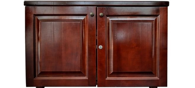

To laminate cabinets in your kitchen, the easiest, and most cost and time effective solution, is to use self-adhesive laminate veneers. The results can be beautiful, at a much lower cost than replacing cabinets.
