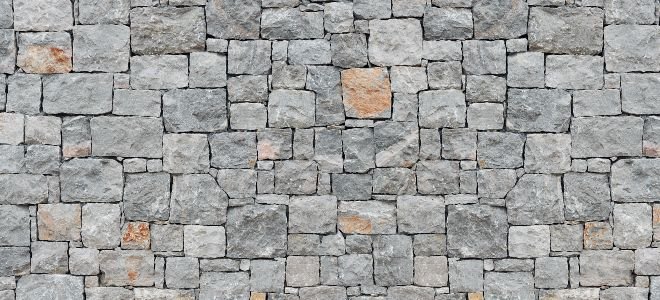

How to Lay Natural Stone Tile
A stone tile.
