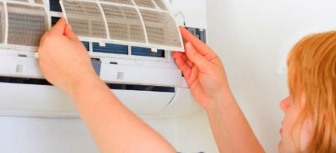

Step 2 – Remove the Filters
Check the arrows on the surface panel for directions on how to remove them. Take down the panel and clean it. Check the air filters for a tab which allows you to remove the filters. Hold the tab and carefully pull out the filters as guided by the arrows.
Step 3 – Clean the Filters
Remove the dust and debris from the filters with the help of a vacuum brush attachment. Wash the filters in warm water with a bit of mild detergent. Use a soft-bristled brush to clean the filters thoroughly. Rinse the filters and place them in a cool, secure place to dry completely. Avoid hot water when you clean your mini split heat pump as it could cause discoloration. It is best to clean your filters every 3 months. However, if you live in a dusty region you’re better off if you clean them more frequently.
Step 4 – Check the Vents and Condenser
Carefully examine the air outlet and intake vents. Sometimes dirt and debris may collect in the outlet. This hampers proper air flow. Use a putty knife to remove obstructions from the outlet and vents. Locate the condenser within the pump. Check to confirm that it is properly mounted. Make adjustments if necessary.
Step 5 - Re-install the Filters
Retrieve your clean filters. Slide the filters into their slot as guided by the arrows. Re-install the panel. Restore the power to your mini heat pump. It should give you regular service.
