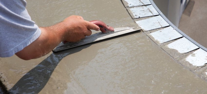

Step 4 – Finish Concrete
Now that you’ve poured the concrete it’s time to texturize it so people that go swimming won’t slip on the cured and sealed concrete surface. So before it dries, pull a push broom over the surface of the concrete. It should make lines in the concrete just like you see on sidewalks. Wait for the concrete to dry.
Next, pull off the wood frame and sand down any barbs hanging off the sides. Fill in the planned breaks with rubber sealant, the black stuff you sometimes see in sidewalks also.
