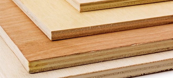

Plywood boards

Plywood boards are ideal for making a simple corner TV stand because they are light, sturdy and easy to cut. Two high quality eight-foot by four-foot plywood boards with ¾-inch thickness are appropriate for this project. Cut one of the boards into two four-foot by four-foot sections. Draw a diagonal line through one of the 4x4-foot squares. Cut along the diagonal line, dividing the square into two triangles. These triangles will form the top and bottom sections of the stand.
