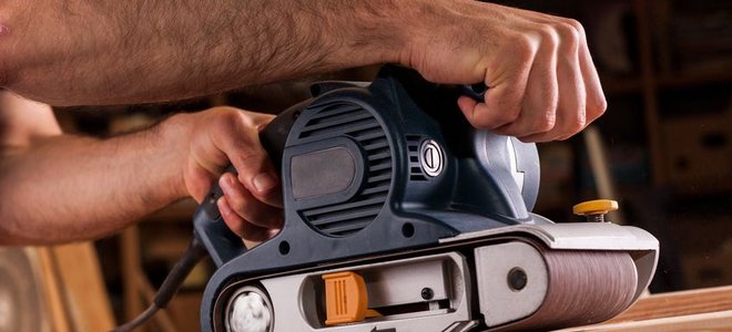

Step 6 - Sand, Paint, and Install Molding
For a finished look, sand the table with a sander. Then, attach a quarter-round molding all the way around the tabletop. Use finish nails to secure it in place.
