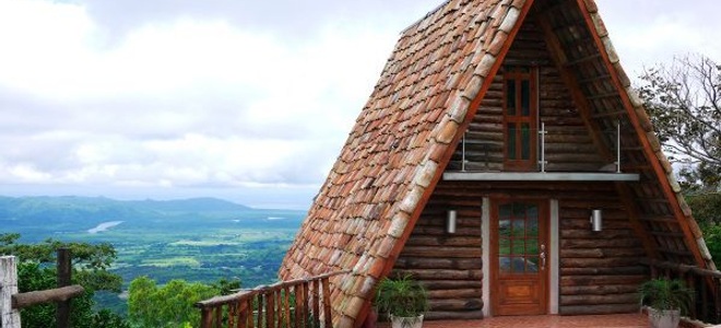

A log cabin can be a lovely addition to a rural home setting and can be a wonderful retreat for a vacation home. This type of project often takes several weeks or months to complete and often requires assistance.
