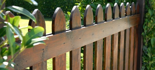

tab topped wood fencing
Shake the can of stain to be sure it is mixed well. Remove the lid and begin applying stain to one small area at a time on your wood fence. After you have applied the stain, take one of the old rags and rub the stain in, while removing a lot of it at the same time. This will give your fence a weathered, old barn-look once dry. Repeat this process on both sides of the fence.
While allowing the fence to dry, clean your paintbrush. If you notice the stain is too heavy on the wood, you can lightly sand it to remove the heavy areas. You will then be ready for the next step, which is protecting the wood stain finish.
Step 3 - Preserve the Finish
Again using your paintbrush, apply a coat of clear wood preservative to the entire fence, on both sides. This will protect the stain finish, and protect the wood from rain and other harmful elements. To keep your fence in good condition, reapply a preservative every one to two years.
