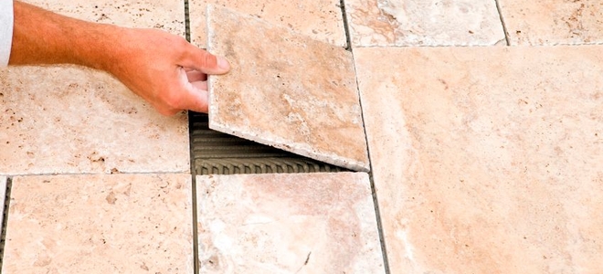

Worker Placing tiles

When you have your surface ready, use the pencil to mark your intended design. Lay the tiles onto the design with the dull side up. Make sure to leave enough room between the tiles for your grout. Wearing eye protection, use the nippers to cut tiles to the right shape and size.
Step 4 - Attach the Tiles
While the tiles are laying dull side up, you can put a little adhesive on them if you want to keep them from moving around on you. You can finish the project without the adhesive, it's up to you. Turn the tiles over and place them in their proper location. Once they are all in place, cover the tiles with the grout, making sure to work the grout in between the tiles.
