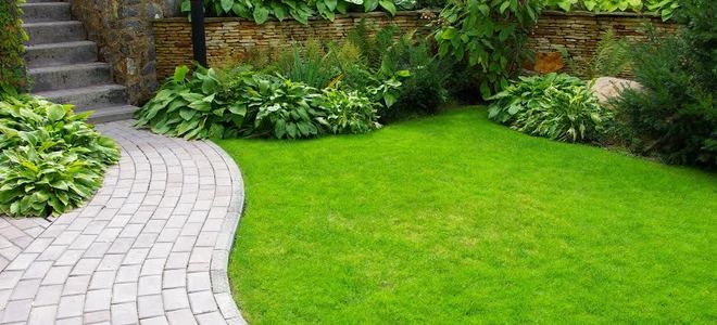

With a few tools and some patience, you can create attractive and functional curves in your pavers made of concrete, brick, stone, or other material.
If you need a gentle curve in your pathway, border, or retaining wall, sometimes you can obtain the shape without any cutting.
Retaining Wall Blocks with Full Pavers
There is some curve built into many styles of retaining wall blocks, which are wider in front than in back. This provides crevices that are filled with dirt, bonding the wall with the earth behind it. But the wedge-shape can also be used to produce a graceful backward curve – the crevice becomes narrower, but still functional.
Try not to totally lose the crevice, or if you must, do so only once or twice in a row. You do still need some crevices to anchor the wall to the earth.
Full Paver Patios and Walkways
You can often just lay these pavers just slightly at an angle to the previous paver and fill the resulting crevice in with dirt or sand.
