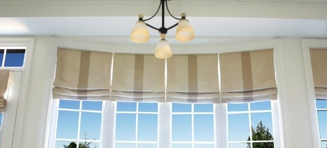

Make your Roman shades unique by adding a decorative bottom hem below the stabilizing dowel. All it takes is precise measurement and a few additional steps to assemble the roman shade. Follow these guidelines to accent your roman shades with a fancy bottom hem. These shades will work equally well in either an inside-frame or outside-frame mounting.
Step 1 - Measure the Window
For an inside mount measure the window length from the top to the window sill or ledge. You need to include the depth of your decorative hem within this length, with a one inch finishing hem depth for it. Measure the width for correct horizontal fit of the roman shade.
