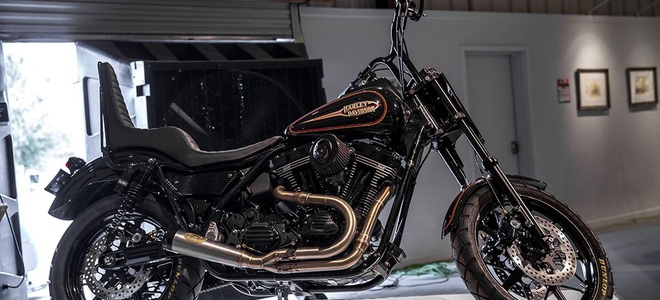

motorcycle with high back seat
Create the shape and form of your seat. Turn your seat over and form the seat by using your mallet as a shaping tool to create the concave and curves of the seat.
