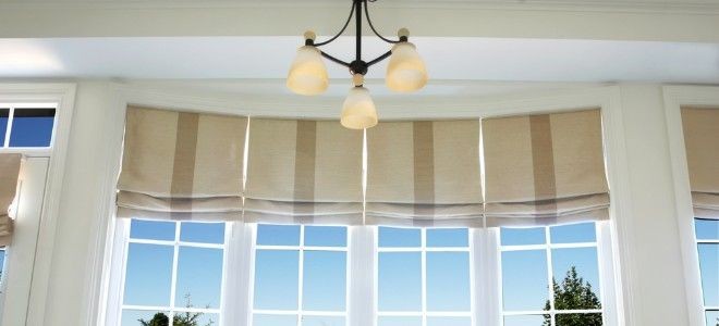

Top-down, bottom-up Roman shades are an ingenious solution to meet two needs: getting light into a room, and ensuring privacy at the same time. These shades work best when mounted outside the window frame to avoid obstructions like window locks. Modify an existing roman shade into the top-down, bottom-up format by following these suggestions.
