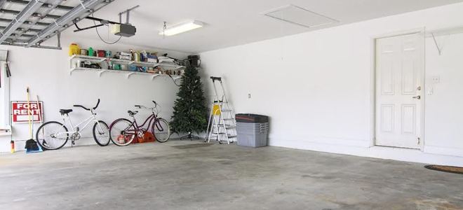

How to Make Your Garage Energy Efficient
A garage with sealed front windows
