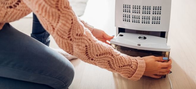

person in sweater opening the bottom of a dehumidifier
