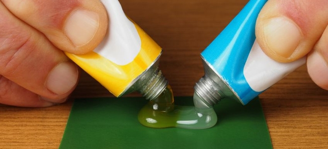

Step 1 - Determine the Ratio of the Ingredients
Determine the ratio of the amount of resin to that of hardener required to prepare the epoxy mix. Do not use these ingredients in random ratios.
Step 2 - Prepare a Sample
mixing epoxy in a pail
Make a sample portion of epoxy by mixing the resin and hardener in small proportions. This will give you an exact idea of what the final results would be like.
Step 3 - Prepare the Final Mixture
If you feel that the end result would be satisfactory, use two containers to take required proportions of resin and hardener and pour them into an empty container (ideally, this should be made of polyethylene plastic; metal is another option. The use of glass containers is a definite no-no). Use stirrer or drill mixer to continue with the mixing process for at least three minutes.
Note that hot mixes harden very rapidly; hence, caution should be exercised while mixing.
