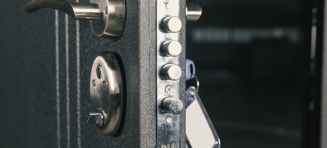

Step 4 - Remove Latches and Use Tape
Before you begin to put any paint onto the metal door you should also first remove any of the latches, knobs, knockers, and any other attachments that are on the door. If they can not be removed, like a mail slot, or a peephole, then use some painters tape to cover them up.
