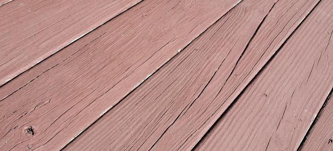

It doesn’t take long before a beautiful wood deck becomes aged and in desperate need of repair, especially after a bad paint job. Luckily, restoring a deck to its original glory is an easy, straightforward process that can be knocked out in a weekend. Here is a quick guide on how to properly paint a deck and get it looking brand new in no time flat.

A lot of people opt for staining a deck, but paint is often a better alternative. Paint is generally thicker than stain and offers better protection and longevity. A good paint job can also hide imperfections on the surface of the deck. The only exception to the rule is when the decking is close to the ground and does not have adequate air circulation under the boards. Without good circulation, the boards are more susceptible to trapping moisture, which can lead to chips and bubbles in the paint.
