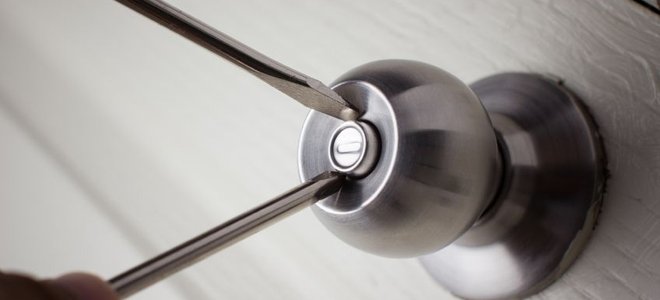

How to Pick a Locked Door Knob
picking a lock
  • 0.5-1
  • 20
Credit card
Hairpin
Flathead and Philips screwdrivers
Credit card
Hairpin
A locked door knob and a lost key are the makings of a frustrating day. Since picking a locked door knob is a skill that even a common thief can master, there’s no reason you can’t break in to your own home as well. The most important factors to consider are the type and age of the knob. Check out the following varieties of door knobs and methods for picking locks.

Traditional Door Knob Lock
traditional door lock
A door knob that has a traditional threaded lock is much harder to bypass. The first way to get through this locked door is to use a credit card. You slide the credit card between the door frame and the latch at a 45-degree angle. It will take some work on your part to properly insert it but when you do the latch will slide over allowing you to open the door.
The other way to break through a threaded lock is to just remove the door knob. Obviously this isn’t convenient if you urgently need to get through a door, but if you have the tools and the time, it’s fairly simple. Just remove the screws in the plate and pull the door knob off the spindle. Older doors will have screws on the stem, not just the plate, of the door knob that you must remove. Other door knobs will have a small push plate on the stem. Use a flathead screwdriver to push it down and while pressing down you can remove the door knob. Once you have access, unlocking is easy.
The biggest downside to this option is, while it guarantees you access, you do have to then take the time to reassemble to the knob and put it back in place once you’ve made it inside.
