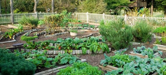

Potager is a French term used to describe an ornamental or kitchen garden. Potager gardens are filled with edible (and sometimes non-edible) plants, herbs, and vegetables. The goal of a potager garden is to enhance the yard's beauty while also providing food.
This article will cover how to build a small, fenced-in potager garden that is perfect for any home chef.

Now that the frame of your garden is completed, it's time to lay out your beds. Raised beds, with or without frames, are great for a potager garden.
You can lay your beds out in any shape or design -- just make sure that you leave a 2-foot minimum walking path between garden beds.
To maximize your space, consider creating a 2-foot deep bed along the interior perimeter of your fence. 2-feet deep is enough to grow a variety of plants, and the fence panels and chicken wire can be used to support climbing plants such as cucumbers and peas. In the middle of your garden you can fit 2 to 3 rectangular beds depending upon the size of your garden.
