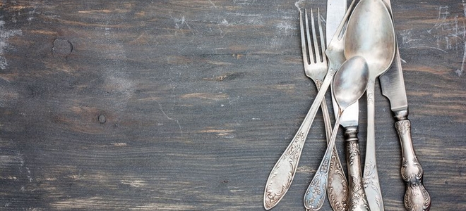

nickel-plated silverware in need of polishing

Many metal items, like jewelry and silverware, are plated with nickel because it’s cheap and has a shiny luster. However, this type of plating tarnishes easily. Check out the different ways you can polish your nickel-plated items to keep them looking newer for longer.
