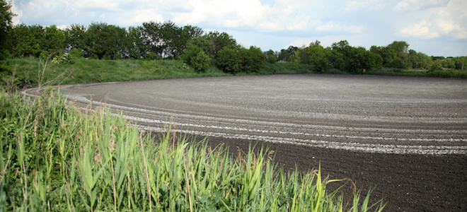

A drain field, or leach field, is the area into which a septic system drains. It is composed of a series of pipes, and material such as gravel and soil. The field works to remove material from the septic system and then to remove the contaminants. There are several things to keep in mind to keep your drain field functioning as it should.

Hiring an engineer to design and implement the drain field is the best way to go. This will ensure that the field meets all local regulations, and will prevent common design flaws. The size of the drain field needed will depend on the percolation rate of the soil and the size of the home. If the soil is poor, it could take as much as 9,000 square feet for the absorption area. This is why an engineer will be best suited to the job. They can test the soil and plan a field accordingly.
2. Block it Off
It's important to know where your drain field is placed. If it's possible to create a barrier, this should be done. Heavy weights, such as that from cars, livestock or other heavy equipment, can crack the pipes used in the field. You also don't want to build anything on top of the drain field. Patios, gazebos, and carports should be built in other areas. Paving over the field can also damage the function, since it will block vital oxygen. Many people will plant gardens over their drain field. While this a good use of the space, you should only use plants that have shallow roots. Trees and shrubs should be kept at least 30 feet away. This will protect the pipes from the rooting that happens with trees and larger shrubs. Shallow plants and grasses will also help prevent soil erosion.
3. Water Runoff
You may need to reorient drainage ditches and gutter systems. Water that is allowed to run into the drain field will saturate the soil, making it weaker and leaving the pipes open to damage. Most engineers suggest creating a separate drain off route for heavy rains as well to help prevent the field from becoming overly saturated.
