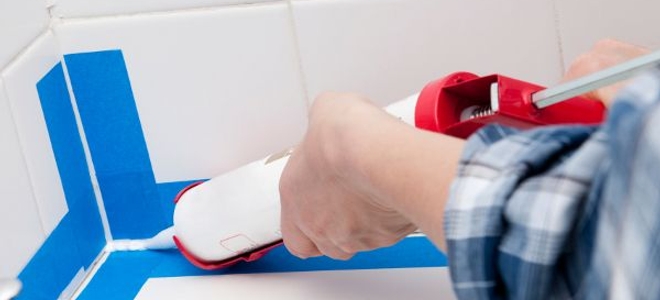

Step 5 - Apply the new caulking
Load the caulking gun and cut a .25-inch diameter slice from the tip at an angle. Press the caulking gun handle slowly to expel the caulking directly around the shower arm, the tile edges, and the tub-tile border. Apply caulking to the tiled corners of the shower walls as well. Wearing your dampened rubber gloves, smooth the caulked bead with your fingers. A mixture of water and dish detergent also works great for smoothing the caulking as it keeps the caulking from sticking to your gloved finger. Wipe away the excess caulk with a damp cloth.
