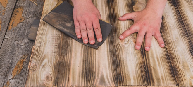

Remove Closet Doors
You will do a much better job when you can refinish your wood closet doors if the doors are removed from the casing. Remove the hinges, or take the doors off the track to remove the door and bring to your work station.
After the door is off, you can take this time to remove the hardware. Using your screwdriver remove all the knobs, latches, hinges, or tracks.
Sand Doors Down
To refinish means you must take off the previous finish. Depending on what it is, you can do it quite easily. For regular wood finish, a random orbital sander will work great to remove the finish. You don't need an aggressive sand paper, a 60 or 80 grit will do. You don't want to damage the doors you just need to remove the old finish.
If you are removing paint, then a good soak in paint remover will be a good idea before scraping it off and then sanding it down to clear wood.
Fill in Scratches or Gouges
Look over the door and fill in any scratches, gouges, or holes you see. Use a wood putty and apply with a small blade putty knife. Wait until the putty has dried and sand down to a smooth finish.
Apply Sealer
With a foam brush apply a coat of wood sealant to keep the stain from penetrating too deep. Wait a few hours until dry and then sand with a 220 grit sand paper.
Apply the Stain or Paint
Depending on what you want, you can apply the desired stain or paint the doors. If you choose to paint the doors then once they are dried you can mount the hardware back on and hang the doors.
If you choose to stain, apply with a foam brush. Start in the middle and brush outwards. Wipe off the excess with a cloth.
Finish Coat
After stain has dried, then apply a satin varnish finish to help your door shine and look new. Once dry, mount the hardware back on and set door back in place.
