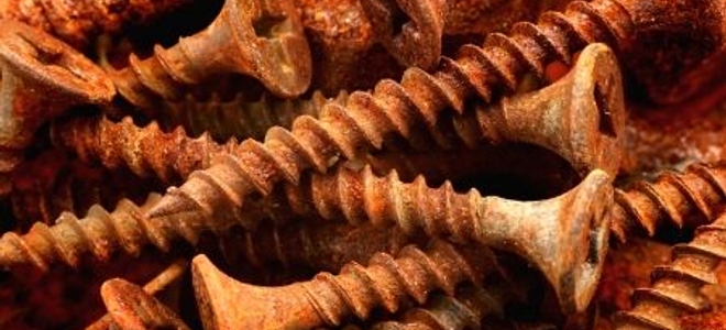

You know you need a screw extractor when your screw’s top groove is stripped or if it’s sheared off completely, removing a broken screw top is frustrating if you don’t know what you’re doing. You can attempt to loosen it by hand for hours, or you can purchase a handy screw extractor for about $5. This handy tool has a square top section and a shaft that ends in threads. These threads are sharply tapered to get inside of a screw shaft to easily remove it from any surface. After purchasing a screw extractor, check out how to use it with the guide below.
