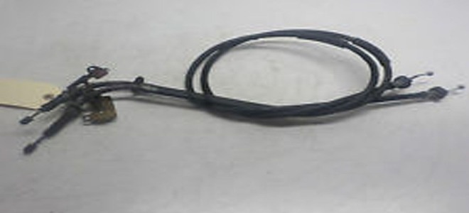

The choke cable determines how much fuel flows into the carburetor. You need a rich mix when you start and this will become leaner as the engine warms. Over time, the choke cable might stretch or even break. When this happens, you need to remove it and fit a new one. Removing a choke cable isn’t an especially complex job and doesn’t even require any special tools.

Now you’ll be able to pull the whole assembly, including the boot and the jet, away from the engine. From here you’ll be able to see how the choke cable fits into the carburetor.
Go to the front of the motorcycle and see where the choke control is on the handlebars. At the back of it you’ll see an adjuster. This allows you to alter the tension of the cable. Use your wrench to loosen it a little. You should go to the point where there’s plenty of slack in the cable. You should now be able to unhook the choke cable from the carburetor.
Step 5 - Remove From the Handlebars
With one end of the choke cable free, you’ll now be able to pull it along the frame, removing an brackets that might impede it. When it’s free, unbolt the locking clips at the back of the handlebars and pull the choke cable through. If you’re putting in a new choke cable, don’t be surprised if it appears shorter than the old one; it won’t have had chance to stretch out yet.
