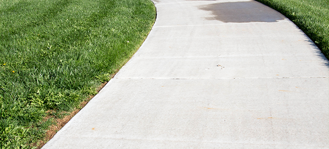

Removing a concrete walkway can be a major undertaking, but with the right equipment and a little know-how, it can be done!
In this job, the rental department at your local home store can be your best friend. You can rent some heavy-duty demolition tools relatively inexpensively. Depending on your physical abilities, you may want to get any of several sizes of air hammers. The largest you can handle will be the most effective.
You probably will want to avoid the very largest, but the second-largest can be very effective. If you try the larger models at the rental desk and don't think you can handle them, you can find them the size of a reciprocating saw. They're much easier to handle but they'll take a lot longer to complete the job.
Note: Even with a large unit, the work is slow and hard; plan on renting the air hammer for at least two days. Due to the unaccustomed difficulty of the work (and the fact that the vibration of the air hammer can upset your stomach or initiate a headache) DO NOT rent the tool for two consecutive days. Do one round, relax a few days, then try again. If possible, take turns on the air hammer with a friend or friends.

Start by positioning your hammer bit in a natural crevice, like the incised line between two walkway squares. Grasp the air hammer firmly and brace yourself to keep control of it.
Step 4 - Work the Area
As the hammer vibrates, it chips small bits of concrete away. Let it rest in one spot for a minute, then move on. You'll soon get the feel of it and will be able to move methodically across the walkway.
