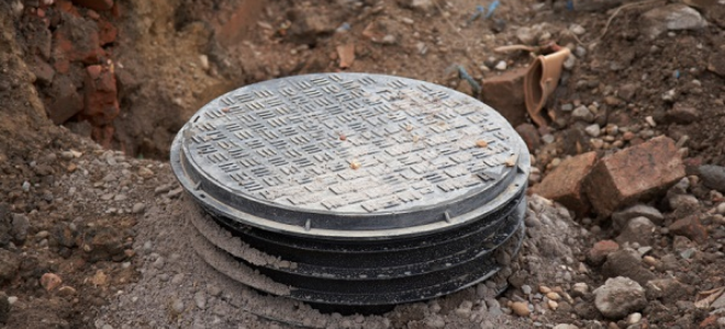

Step 2 - Dig Up Septic Tank Lid
After you have found the septic tank, you can begin the process of digging up the lid. Use a shovel to excavate the ground around the tank until you find the lid. It will be flat against the tank with a small seam around it. Dig the ground to create at least 16 inches of clearance on all sides of the lid. It is also recommended that you slope the land as you dig down to the lid so that the gravel will not fall back in.
Step 3 - Pry Off Septic Tank Lid
Depending on the size of the septic tank, the lid can be quite heavy. It is a solid piece of concrete that is flat on all sides. It may have a handle to pull on. The majority of septic tank lids will require a pry bar to lift them out of their seating. Set the prybar in the seam and press down. As the lid lifts out of the hole, have someone move it to the side. Set the lid on the surface of the ground out of the way of the pumping vehicle.
Remove a Septic Tank Lid FAQ
How do you lift a septic tank lid?
Before lifting a septic tank lid, scrape all the dirt away to start with a clean lid. Insert a screwdriver into the seam of the lid to break the seal.
When you have a small opening, use a pry bar to lift the lid the rest of the way. If you're going to remove or move the lid, get help from at least one more person because this is not a solo task.
