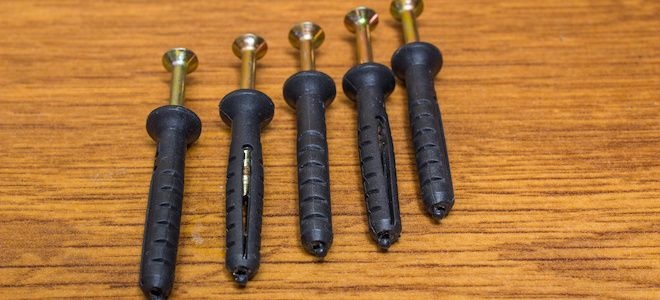

As great as wall anchors are for hanging photo frames, mirrors, or bookshelves on a wall, they can lead to a stressful situation if you decide you want to move some wall hangings and get rid of the wall anchors. Although sometimes just pulling them out with an appropriate tool can seem like the answer, it can lead to an ugly hole in your wall in place of the removed anchor that will ruin the look of the room and wall. Here is a step-by-step guide to removing a stubborn wall anchor with minimal and easily fixable mess without causing any permanent damage to the wall.

Take a pair of needle-nose pliers and grab the edge of the wall anchor’s head. Bend and pull the head while shifting to pull from different diagonal angles. The trick is to apply enough pressure to visibly loosen the wall anchor, but not to pull it out completely. The wall anchor must be loosened and pulled out just about 1 mm.

After the anchor head has been cut off, some part of the anchor remains in the wall. Using a screwdriver, push this part of the wall anchor fully inside. This will leave you with just a tiny, proportionate hole in the wall which will be extremely easy to patch.
