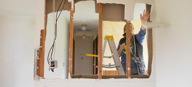

Drywall Removal
Someone demo-ing a wall with a prybar.
While it's tempting to bust out the sledgehammer and get to work, it's easier and more efficient to use a reciprocating saw. Begin by cutting between studs and pulling off large pieces of drywall by hand. Drywall tends to come off easier in large chunks than small ones. Use a small pry bar with a claw attachment for the more stubborn pieces. Remember to wear safety goggles and a breathing mask to avoid inhaling the fine chunks of drywall. Haul away the demolished drywall using construction-grade garbage bags.
