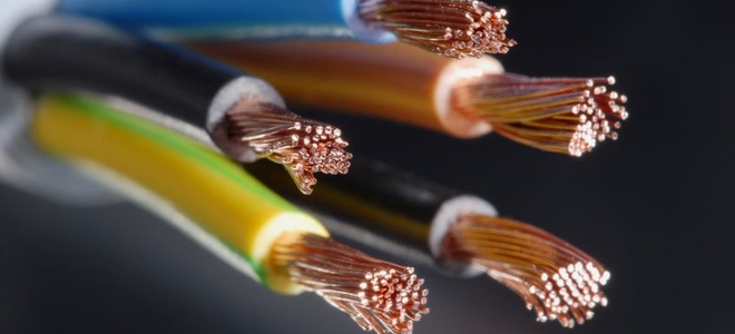

Oxidation isn't always limited to what you can see—it can creep up inside wiring insulation, and if you don't remove all of it, it will simply grow over the rest of the wire again. So before you begin cleaning the copper wire, it's best to strip the insulation far enough back to make sure you are getting all of the corrosion off in one sweep.
copper wires with exposed tips
