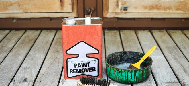

When deciding how to remove paint, you have a number of options. Determine how much paint you need to remove, from which surface, and you can make the task much easier and faster. Follow these guidelines below to remove paint from interior surfaces.
Step 1 - Find Out the Base Under the Paint
If the wall material under the paint is drywall, do not use chemical paint removers, as they can damage the drywall. Use a sander to clear layers of paint off drywall. Use a sander as well if you are removing paint from hardwood floors or plain door frames. You will need to use chemical paint stripper on molded baseboards, as sanding will destroy their contours.
Step 2 - Clean the Painted Surface
Clean the painted surface thoroughly with a grease-cutting cleaner. Dish detergent or an all-purpose household cleaner will work well. Rinse the surface well, and let it dry overnight.
Step 3 - Tape Off Edges
Tape off the edges of the area where you will be removing paint, so you don't sand or spray into areas where paint is not being removed.
Step 4 - Apply Paint Remover
Many paint removers that are environment-friendly come in a trigger spray bottle. Spray the paint remover onto the wall or baseboard and allow it to stand for a few minutes, then wipe it off with paper towels or clean rags. Use a paint scraper to lift off paint flakes that don't dissolve in the paint remover.
Wear eye goggles and a face mask even when using environment-friendly paint removers, and work in a well-aired space. Dispose of your wiping cloths and paper towels in the regular trash.
