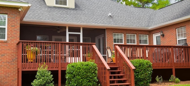

Removing the stain from your wood deck may become necessary if it has become sun bleached and weather-worn. Dull looking decks can be made almost new again by removing the old stain and replacing it. There are two methods you can use to accomplish this. Choose the stain stripper method if your wood is in good condition and doesn't have thick layers of finish to remove. Opt for the sanding method if you have multiple thick coats to penetrate or the wood needs extra smoothing.
