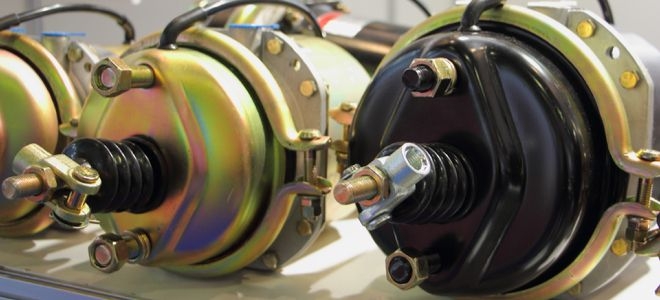

Brake boosters are vacuum-powered vehicle elements that increases brake pressure in accordance with pedal action.
If your vehicle brakes are doing less with more foot pressure on pedal, you might have a bad brake booster. Here are some repair tips.
