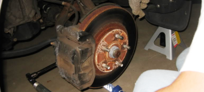

Are you familiar with how to repair a brake rotor? Brake rotors, depending on their condition, should be refinished or replaced when the brakes are realigned. They absorb much of the heat created by the friction of the brake pads against them during braking. Things like stress cracks, deeply pitted areas from rust, getting out of round (run out), deep grooves in the surface, or being worn down to minimum specifications or the discard thickness are indicators that it is time to replace the brake rotors. Before replacing the rotors, you can repair them by filing them down (to reduce the uneven spots) or taking them to a mechanic to 'true-up' or re-shape appropriately. Here is what you need to do to repair the brake rotors, in an effort to save some money on the replacement.

Step 4 - Pull off the Brake Pads
Remove the brake pads carefully to expose the rotor.
Step 5 - Pull off the Rotor
Using the right amount of torque, remove the lug nuts that hold the rotor in place. You will need the right socket to take the rotors off properly
Step 6 - File the Rotor
Using a small file, intended to file down a brake rotor, gently file the surface until you get an even and smooth surface. Do not try to over file.
Step 7 - Re-Assemble
Reassemble your braking system for that wheel. Put the rotor back on and tighten into place. Add a little lubricant. Put your brake pads back on second and then add the wheel back on. Make sure everything is tight. Proceed to each wheel, as required.
