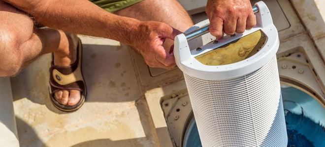

Step 2 - Clear the Filter Basket
person removing pool filter
The first place to look for obstructions is in the filter basket. The basket is easily accessible and is always located in a clearly visible area. Pull the basket out of its recess and remove any foreign objects you find in it. If your pool is close to trees or bushes, it's likely that leaves, berries or small twigs have been sucked up by the pump. After the basket is clear, turn the electricity to the pump back on and see how it is functioning. If the suction has returned, your repair is over. If there still seems to be something blocking your pool pump, you'll have to shut the pump off again and move on to the next step.
