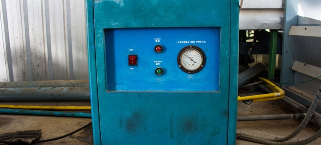

How to Repair a Swamp Cooler Motor
Teal-colored swamp cooler in a shop
