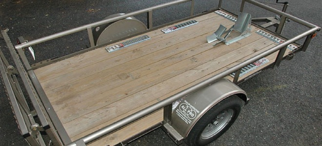

How to Repair a Trailer Tire
utility trailer

All too often, you will need to stop and repair a trailer tire just when the family is settled in the car or truck, ready to go. Trailer tires must be repaired from the inside as their liner is made to hold air more effectively than an inner tube. Follow these directions to repair your trailer tire speedily and safely.
Step 1 - Remove the Tire and Wheel from the Trailer
Block all the trailer wheels not being removed. Loosen the wheel lug nuts 1/2 their turning distance. Jack up the trailer so the wheel and tire are well clear of the ground, and finish releasing the wheel lug nuts to remove the wheel.
