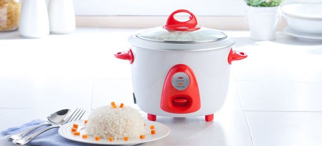

How to Repair an Electric Rice Cooker
A small white and red rice cooker sitting on a counter beside a dish of prepared white rice.
