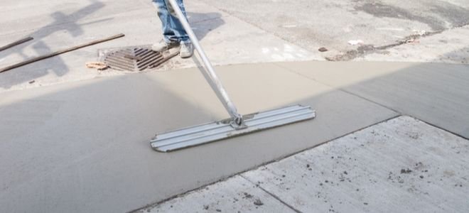

Step 3 - Make and Install a Form
Measure the size of the sidewalk block that has to be placed and transfer those measurements to the 2x4s; cut them out. Connect the 2x4s together to form a box the same size as the sidewalk blocks. Move the form over the block to repair and use the shovel to dig a small trench around the concrete block. Position the form over the block and use the mallet to tap it in place until it's properly seated and level with the ground. Tamp down the earth to create a flat surface for the concrete.
Step 4 - Repair the Sidewalk Blocks
It's important to use the same concrete (or one very similar) that was originally used for the sidewalk blocks. This will make a perfect match. Mix the concrete inside of a bucket with water. Read the bag to determine the proper amounts of water and concrete. Attach the mixing attachment to the drill and mix the concrete until it is coarse and lumpy. Pour the concrete into the form in the void left by the damaged piece. Allow for it to cure prior to removing the form. You can then use the removed dirt to fill in the trenches.
