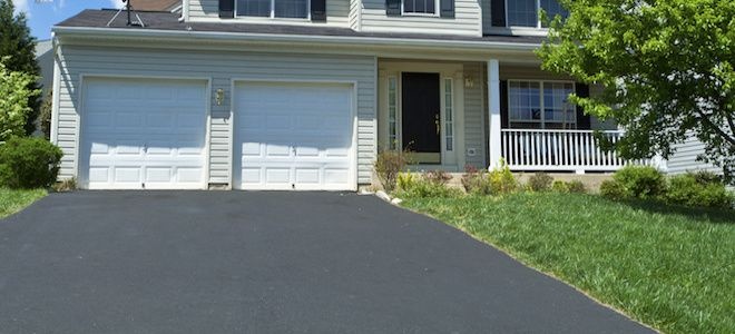

If you have a crack or split in your asphalt or blacktop driveway, you'll need to repair it as quickly as you can. Cracks can be caused by the pressure of vehicles, but the driveway can also be made vulnerable to this damage by the cold weather, followed by a long hot spell. These weather patterns can quickly make a large crack in your blacktop driveway, so to prevent it from getting out of hand, you need to repair it before your car tire falls into the crack, or before your neighbors start protesting about the split in your driveway.
You can repair a blacktop driveway fairly easily by picking up some blacktop filler on Amazon and following our quick step-by-step guide.
