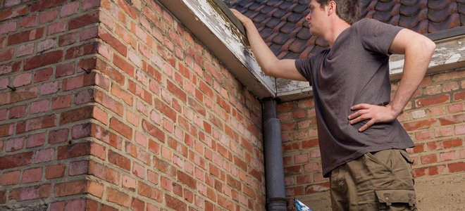

Gutter leaks can cause large amounts of water to flow down the side of your house which can cause cosmetic or structural damage. Gutters are used to collect excess water during rainfall which will be diverted away and drained. Gutter leaks often appear at joints and downspouts and need to be fixed quickly to prevent damage to the structure of your roof or home. This can be done easily by a novice DIY enthusiast.
Step 1 - Scrub the Crack
Use an extension ladder to gain access to the gutter. Once the leak point has been pinpointed, scrub the area around the crack to remove any buildup. The area needs to be clean so a small replacement sheet of plastic will fit tightly into place. Use a small piece of steel wool and scrub the crack gently to provide a clean, etched surface. Have a small pot of warm water on hand to dip the wool into frequently. The damp wool helps to reduce dirt and debris. Once the area is thoroughly cleaned, use a piece of sandpaper to smooth the edges of the crack. If any plastic fibers from the steel wool are stuck in the crack, remove them using a pair of scissors.
