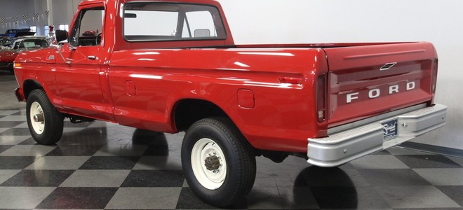

Everyday wear and tear can play havoc with truck paint and before too long, body panels can become littered with scratches and abrasions. Although some scratches will be too deep to carry out an invisible repair, they can be significantly reduced while smaller scratches in your truck paint can be eliminated completely.
