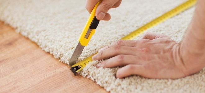

Step 2 – Cut the Damaged Area
Use a carpet cutter to remove the damaged area. Cut the smallest portion possible.
