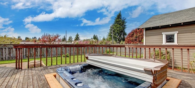

Hot tub covers are one of the most important parts of your hot tub, keeping out foreign objects and debris that can damage the liner or clog the jets. This is especially true if it is kept outside on a patio or deck in the natural elements. In these conditions, however, your cover can go through extreme changes between hot and cold and wet and dry, which can lead to severe damage over time. Learn what you can do to prevent damage over time and how you can repair it when it does happen.
