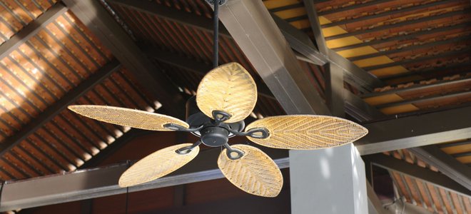

How to Replace a Ceiling Fan Pull
A ceiling fan.
