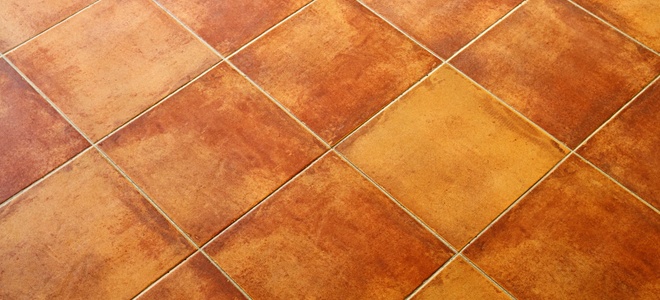

When you install terracotta floor tile in your home you'll be creating a beautiful setting. Terracotta floor tile is expensive but is worth the investment since it is a desirable look for potential buyers. Terracotta floor tile is not impervious to damage and can break. If this should happen to you then you will need to replace the tile. This is a job that is not difficult to complete and with a few tools can be done quickly. The article below will show you how to replace a broken terracotta tile.

Room with terra cotta tile flooring
A faulty floor can be the cause of breaking tiles. If the floor buckles as you step it can cause the floor tiles to crack. If the floor is loose then use nails or screws to secure it. Also level areas that need it.
