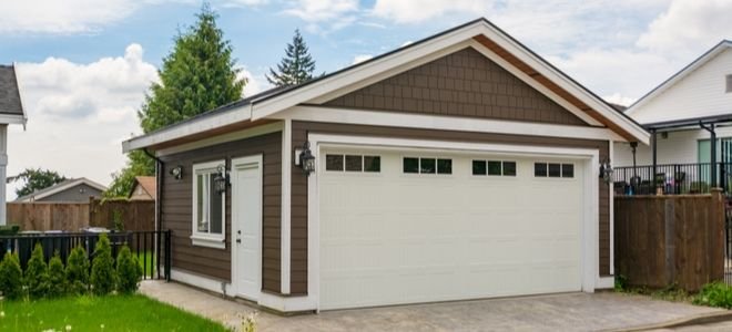

A defective garage door seal will allow many unwanted things to get into your garage. For example, a defective or missing seal will allow dirt, debris, dust, rain, and snow to get in. They are a way for insects and pests into your home, and defective seals increase the cost cooling or heating. Installing a garage door seal is relatively easy, and there are many types of seal kits available. Here is a handy step-by-step guide to help you install a new garage door seal.
