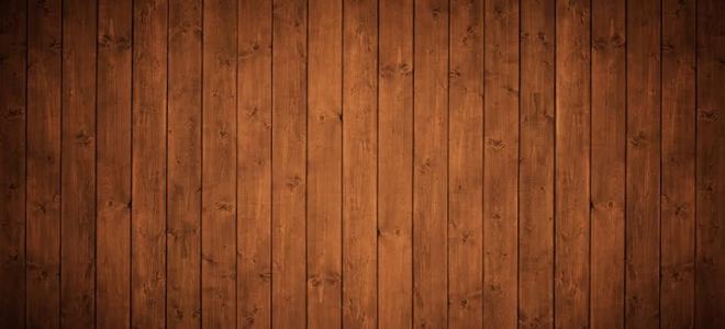

Step 2 - Remove the Old
old wall paneling
Removing the old garage wall panel is a snap. Locate the panel (or panels) you wish to remove and then find the seams. The panels are connected directly to the frame of the garage with nails. Use your pry bar and place it in the seam. You may need to gently tape it in place with a hammer. Apply leverage to pull the panel away from the frame. Continue along the perimeter of the panel until you can remove it.
