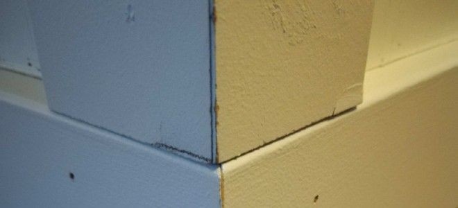

Installing a corner baseboard to your floor or wall can serve several different purposes. First, it will create a finished look for your room. Second, the floor baseboard will protect the wall from damage from vacuum cleaners, mops, and small toys. Protecting does mean damage though -- damage to the corner baseboard. Replacing a piece of corner baseboard is not as hard as you may think. Here are a few steps to replace your corner baseboard quickly and easily.

Set your baseboard on the mitre saw deck and stand it on its edge. Line up your mark and cut the 45 degree angle. Make sure your angle is going the right direction.
